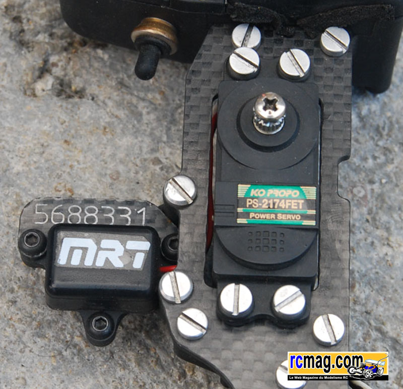

Posté le: 14.05.2010, 19:31:00 Sujet du message: |
toujours d'actualité ces puces
pour les courses Officiel de TT 1/8
http://images1.hiboox.com/images/1910/diapoc926b1084ea65818dd5a5b3270c6e672.jpg?24
PTX Personal Transponder
Stored ID's: 10 or 20, also 20+1 (+1 Custom ID or Cloned ID)
Case version: 22 x 16 x 7mm, waterproof and fuelproof
Shrink version: 21 x 13 x 7mm, not waterproof (indoor use)
Weight: approx 3g case, 2g shrink (without power lead)
Mounting: direct fitting base or tab case (3 hole base)
Temperature range: 0-50 C
Power feed: from a free RX channel (or 'Batt')
